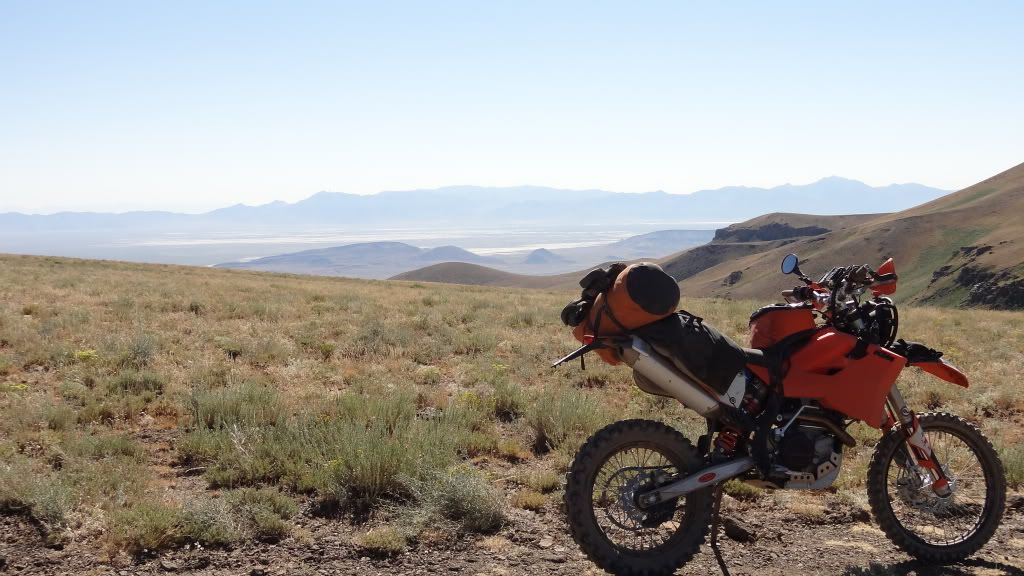

I've done about 5000 desert miles and 151hrs on my 530EXC now and it's been absolutely perfect for the kind of riding I do with it. There isn't any other bike I'd currently trade my 530 for.....well except another 530!
I have a friend that decided to sell his low hr 2010 Sixdays 530 set up very similar to mine so I decided to sell my trusty steed and purchase his (a fast way to take 100 hrs off my bike). I swapped a few key components around and put my 2010 Champion Edition 530 (Redbull) up for sale and had it sold within a few days.
My Redbull bike on our last desert trip together

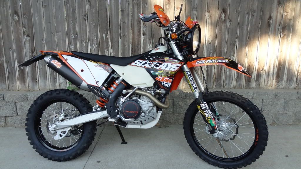

And a picture of my "new" Sixdays 530....almost ready for a distance trip to the desert. I still have a couple minor items to install etc.
And here's a list of my mods/farkles that I've added to the bike to make it reliable out in the middle of nowhere as well as a list of the equipment that I use during desert trips.
